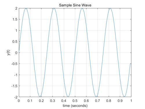

从一个简单正弦信号开始吧,正弦信号定义为:
我们现在通过以下代码在Matlab中画出这个正弦曲线
fo = 4; %frequency of the sine wave
* ?3 m1 {; q% t5 M% u, [3 c* eFs = 100; %sampling rate. q2 b& C. q8 I% t# X4 _
Ts = 1/Fs; %sampling time interval6 n: _2 \% K* N! o; U! b: D6 g! l
t = 0:Ts:1-Ts; %sampling period4 V& c( D7 X+ W4 i/ A
n = length(t); %number of samples$ _0 [0 F. ^1 N0 S1 N
y = 2*sin(2*pi*fo*t); %the sine curve
4 K# c# T" \. A/ n0 x
9 I" {, Q" I! u# U4 A%plot the cosine curve in the time domain
3 c$ Y7 ]7 n4 |- g% UsinePlot = figure;
& s2 ?% O5 v. C; w1 E- q6 dplot(t,y)
7 h; t0 \8 f: B0 s1 Kxlabel('time (seconds)')
" z. ?2 d, Z7 }. ], i1 Zylabel('y(t)')% T  ^4 K$ C: {5 U
title('Sample Sine Wave')7 O+ u# N$ w" {" }
grid
这就是我们得到的:
